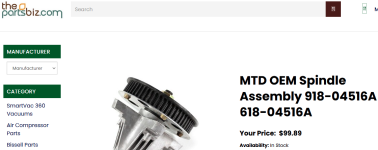

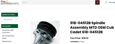

Spindle housing is PN 619-04199 (about $40) vs the 918-04512B or 918-04516A (depends on which spindle assy is needed. Don't forget to get new spindle mounting screws as they tend to break off removing or installing the old ones.

If you do a thorough search online by the part number, you can find the assembly a little cheaper than almost $200. I had rather replace the entire spindle to make sure it is done right & all parts match & there is no wear. Clean everything & LOOK closely at the other spindle as well . Vibration can cause damage to other areas of the deck.
