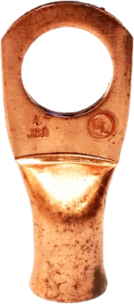

Corroded ring terminal, battery cable

I don’t like crimping battery cable connectors as it provides a path for calcium deposits to leach up through the braided wire. In wet climates this will shorten the life of the connection.
110
12,235
With the crimpers I got I can crimp down so much on the cable lugs that the strand wire becomes solid. But normally I prefer to use No ox coating and crimp just to a good tight fit.
Also you should be using some heat shrink over the connection to make them moisture resistant.

This is the only type I use. Heat and fill the lug with solder, insert cable. After it has cooled give it a coat of liquid tape.
