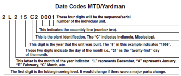

You got realize that you have a 2017 mower in front of you so a 2010 IPL is no good; unless, it is a 2007 model. But what 1 am finding none was built in 2007 with exact model number you posted.

No, I didn't know it was a 2017 model, it was given to me by a neighbor; but now I do ! Thanks.
