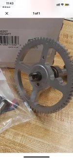

Do you know if the cam shaft style would make a difference? My old one is rounded at the end while the new one is slotted. From what I understand, the slotted one is also used for an engine with an oil pump.

As long as it is the 793880 superseded to 84005207 no it doesn't. Briggs went the oil pump only version to reduce inventory stocking.
