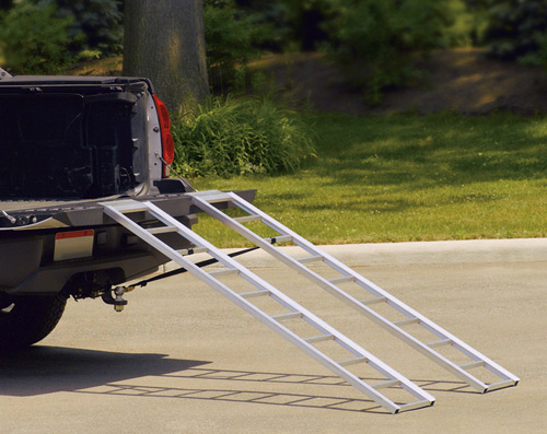

Your trailer deck already appears to be higher in the front. Leveling out the deck by lowering it any will just make the ramp to trailer transition angle greater chance of bottoming out the mower deck. My suggestion would be to extend your ramps or backing up to a curb or higher approach area to your ramp. You could use a two piece ramp to extend your existing ramps such as pictured below. You still would need to elevate your end to your existing ramp with some wood post etc. though. Also you could replace your wheels and tires with smaller diameter ones though this may be cost prohibitive.

The mower deck is at the highest setting. Maybe if I buy curved steel ramps it would work. What do you guys think?

Have a longer gate built. Or use the curved ramps.
