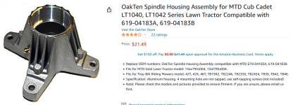

Now the OEM 719-07293-M spindle housings are only retails for 35 usd each but double check per your actual model number as there may be a different version used. And these are available in after market for as little as 21.50 usd each thru Amazon. So is it worth all the time and money wasted?
Not worth the effort trying to remove or even drill through the steel self tappers in the aluminum housing. How do I know this.

Relative to spindles, I just bought and installed an Amazon Asian assembly from PetMigo. [Yeah, me too.] It looked fine tho, has a grease fitting, but no weep hole to know when the housing is full, and gone are those self-tappers -- replaced thankfully by capscrews into a threaded spindle assembly. As a belt and suspenders guy I put lockwashers and nuts on the protrusions sans instructions. 2016 CC ZRT.
