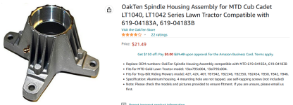

Right in shops it is simply not economical to waste a day trying trying a few pennies. Tri Lobe screws are very hard to get out due oxidation. But of a homeowner time is worth something in my opinion but others like to consider it not worth a penny like the IRS.
Now the OEM 719-07293-M spindle housings are only retails for 35 usd each but double check per your actual model number as there may be a different version used. And these are available in after market for as little as 21.50 usd each thru Amazon. So is it worth all the time and money wasted?
