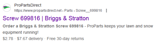

699816
The lowest price per I found is
But if threads are 1/4-20 then you should able it in a flange screw locally, just won't have the T30 slot.
