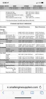

What exactly is “reject size” compared to standard size?

It how much the cylinder and other components are worn beyond a normal size. If the measurement is at or beyond the reject size then the next over or under size need to be used. If it is the cylinder then rigid honing to the next oversize is needed. Most Briggs engines now only have 0.020 inch over size piston and rings available along with standard size piston and rings..
When checking the cylinder it must be done at top middle and bottom of the stroke. And it is done twice at each level with one at 90 degrees of the first measurement of each level. What you are checking for overall wear, ovaling, and tapering cylinder. What I have seen on most Briggs v-twin verticals is that #2 cylinder tend to be the one that wears out first and is usually oval at the bottom of the stroke.

Thanks so much! Just a couple of additional questions….
1. The cylinder with rod that did not break (cylinder 2) had 130 psi of compression, which I assume is good. Does this mean it is Lilly in spec? I know I have to check but how can an out of spec cylinder have excellent compression?
2. What is the camshaft spec again? When I measured the hole in the crankcase and sump that the cam rides in, it measured around .503 which does not seem right.
