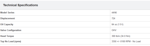

Specifically is this for Intek engines, twins or??? That is 25ft lbs converted.
From what I am finding that torque spec maybe specific to the 44 series engines. Found a 40 series that is still showing the 220 in/lb but the 44 series is showing 300 in/lb. Also found that certain 21-28-31-33 series single inteks are 250 in/lb but other models are 220 in/lb and the OHV single service manual doesn't reflect that change either, but there is a APSI showing that change dated 2012 and the engine manual was supposed to be updated but shows the old information.

Briggs changed the torque to 300 in/lb, but never updated the service manuals.
Do you have a printed source for this information, or was it passed through a "grapevine" network? Was this on one particular v-twin engine design?

IL like me have dealer access to the Briggs info.
The APSI (advance product service info) # 87 has the changes for the 21-28-31-33 series. As for the 44 series in this thread we are referencing the Power Portal specs for this engine.
I have only posted the head torque spec. all other torques specs were deleted.

Thanks Star Tech,
Many of us have always worked with published manuals or CD copies and seldom see the updates that come along.
