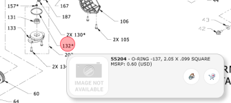

Would need the actual model of the BB or the HG transaxle to check parts.
But if you are referring the new charge pump cover gasket for ZT-2800, ZT-3100, ZT-3400 series. It comes with a .103 x 2.05 (dash -137) o-ring you can try changing it to the .099 x 2.05 square cut o-ring PN 55204.

2018 ZT ELITE.
ZL-KCEF-3BKC-1PXX LH Hydro
ZL-KCEF-3BKC-1PXX RH Hydro
HG-72274 Charge cover kit. List for $59.70.
And should come with a new gerotor set.
