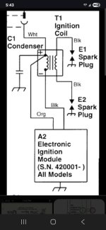

Look at this wiring diagram from an onan engine. What happens when you disconnect a plug wire to try and run on one cylinder?
this is termed waste spark ignition.
normally when a plug wire is purposely pulled the Onan waste spark ignition engine will not run on the opposite cylinder because the spark plugs are in series. (kills the spark to both cylinders)

So...on an Onan two cylinder opposed, is there but one coil for both since both would fire at the same time. The only way for plugs to be in series would be on the opposed cylinder models.
But looking at the diagram from post 62 shows the outputs to be in parallel, not series.
Any V configuration would require two coils to service it's particular cylinder but you still get wasted spark there, too.
