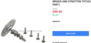

I have a Craftsman 917.203900 with a Briggs Engine 44R677-0021-G1 (2 cyl,22HP)
Sometimes it is HARD to start unless I roll the engine past compression cycle. (It acts like a low or dead Battery) I assumed it has an issue with ACR.
I just finished adjusting the Valves the intake on both were very loose. Now all is good with that adjustment.
One Youtube video showed to roll the engine and watch for the rocker to make a slight dip when closing.
I watched very closely and do not see any form of rocker arm dip. So I wanted to verify, does my engine actually have the ACR?
if it does.......Do I need to replace the 4 lobed Cam, ( PN 797242) or something else?

Pictures of that cam do show an ACR. Don't see many failures with the twin cams but could be possible. So if the bump isn't happening on the valves then there is a good chance that the ACR is broken. So the only option would be to replace the camshaft.
110
12,107
Ran into this recently helping someone on another forum. Depending when the engine was it might still have the non ACR camshaft. Briggs did supersede it to new the newer ACR camshaft and replacements will be the ACR style camshaft.
The old PN 792555 was superseded to 797242 version.

I do see a Mfr date of Jan 2014 on the engine, if that helps nail down if I actually have ACR or not.
Should I go thru the trouble to add the newer Cam with the ACR? or live with the occasional Roll the engine manually to get over the compression stroke so it has momentum to spin and start up?

I have only seen ACRs on Vtwins newer than 2018 I think. I know for a fact that yours does NOT have it. These Briggs Vtwins always have high compression. I say replace starter and battery and clean the Battery cable ends and the starter mounting surface with a wire brush.
