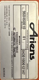

model number pretty please.
freebo86
Oct 21, 2017
11
My bad.. 936048
