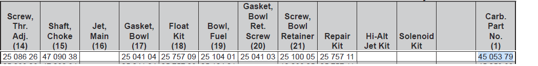

The Walbro carb is an adjustable jet (their term.) # 45 053 79 Apparently used in 4 to 6 K341 model variations and 1 M16 model.
Repair Kit - # 25 757 11 I have ordered it 4 diff. times on 'net. None had the float needle to match existing. BUT the last had the float valve
correct square body shape but too short. I used orig. valve and new attachment spring, gaskets.
See images for more info.

Which Walbro WHG do you have just to verify the correct Walbro kit? Beside it is better to order the Walbro repair kit instead of the Kohler kit. It also appears that all 25 versions of the WHG did used the K1-WHG kit. Also you may need to adjust the float hinge.

Thanks for reply. I adj. per the Kohler K341 repair manual. I checked the K1 kit. The float valve is correct square shape, but its hanger is diff.
Mine is a round, spring shape. It threads onto top of valve. Can't tell from pics if it's same overall length. :(
I've talked Kohler and Walbro tech. persons. Neither could find my carb number in their data. I did find it in photo copies
of old data. Guess I'll order a K1 and hope.
