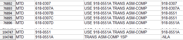

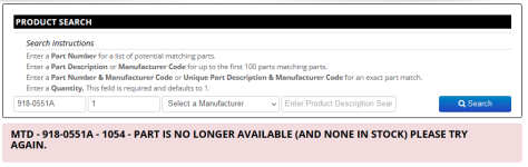

First you don't have the 618-0307C but instead have the 918-0551A which NLA. You must find an used good unit.

Either way, I figured it was NLA. I would like to know if I need an exact number match or if there are other transaxles that I could use (expecting used as well).

Ahh that number was superseded by MTD before they obsoleted it.
Here is the supersede list from my recent price download.
