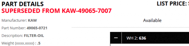

Kawasaki only has two filters 49065-0721 and the 49065-0724 they are completely interchangeable as long they will screw on the oil filter housing and nothing interferes with the fit.
I'll tell ya I have both these filters here, & the 49065--0724 is a very skinny filter in comparison. I will try & avoid using it. But that's just a preference.

rite now the 49065-0724 is all we can get so that is what we have to use and sell.

Funny if I wanted to use the 49065-721 the distributor I use warehouse has plenty but I usually just use the AM Briggs replacement filter I have in stock. Of course 636 filters might less than you need.
And know I was told the 49065-0721 is replaced with 49065-0724, IDK about that ?
