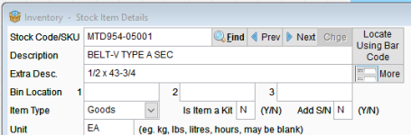

Many after market are spec at 1/2 x 43-1/2. If going with remember to measure the belt before installing.
The heavy duty one I just looked up at amazon, link above, is 43-1/2, so is the other one I bought for that mower. Hmmm. Thanks.
