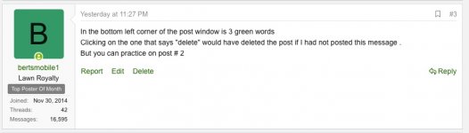

only you can delete your own posts
YOUR posts should look like this IF YOU ARE LOGGED IN
The initial post will have the 3 words as above up until it gets a response when it can no longer be removed for obvious reasons.
All subsequent posts will have the 3 words for a few days till they get archived when Edit & Delete get deactivated .
Note when you read the thread you only see the word "Report" on my post because IT IS MINE so only I can remove or edit it,
