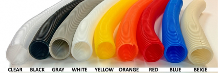

I would dress up those wires with plastic loom and some zip ties. Or electrical tape if you have some.
