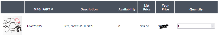

Pump seal kit is PN 70525 Available. IT just my vendor don't have it in stock

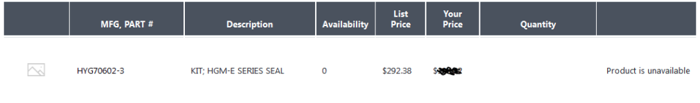

Wheel motor seal kit PN 7602-3 NLA

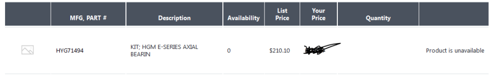

Wheel bearing kit PN 71494 NLA
Hi: I'm a little unclear on direction from your message. You said "Now the they offer both a seal kit and a bearing kit." Looking at the left wheel motor kit, it says the Product is unavailable. Do I have that correct ? Is the seal kit for the wheel motor out of stock or entirely unavailable. If so, then I pretty much have to get an aftermarket "Oregon" brand replacement for the left hand wheel motor.... as opposed to rebuilding the wheel motor. (?) Thanks
Yes that correct they apparently quit providing the kits or at least the dealer website say they are NLA so your only choice is a replacement wheel motor.
