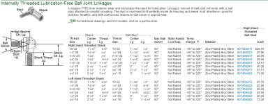

Husqvarna 1640J NLA
McMasters-Carr
My have to lengthen the rod some to offset the removal the ball joint.

IT is a forged and heat treated end so your solution will not happen.
Been there done that
Look your end up from the table Star has posted and buy a replacement
Meaure the threads carefully because some mower tie rod ends are unique combinations of threads .

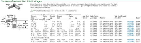

Thanks Star Tech. The diameter of my drag link rod is 0.638". If I cut the failed ball joint off, there would be a challenge to mount the linkages you show from McMasters-Carr. I don't have the ability to turn down the link so it could be threaded to fit the new joint. Might have to weld. Also, is that from an old catalog? What I find online their prices are about doubled. I find a drag link for a different Craftsman tractor online for $20 and I'd get two links from that. Sounds like best way out is buy that and cannibalize that link. That is if hammering on my orig. link doesn't tighten it up so it stays together.
