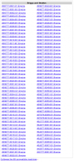

The 694012 covers these engines.
The 84001915 kit for the following engines.
Your choice. The Kit PN Bert does contains head gaskets that have a fire ring which make them a better choice but the kit may not contain all the correct gaskets for your engine. Also if the 84001915 was a supersede kit for the 694012 Briggs would have noted such in the latest price file that I downloaded in late October 2021.
