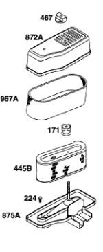

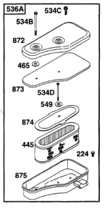

IPL does not show a pre-filter for that particular filter.
The filter you posted is for this air cleaner.
Now there is another filter for the following air cleaner that does have a pre-filter.

The 393725 doesn't use a foam wrap, or I have never seen one on that filter. What makes things confusing is that model type list 4 different filters with one being an oil type foam. One being a round cartridge filter with precleaner wrap. And 2 oblong cartridge filters with one using a foam wrap and one without.
