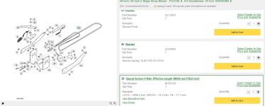

I kept the cardboard sleeve from the John Deere belt I purchased from the John Deere dealership. It is #158130 as you mentioned in your response. I also viewed the video link you attached, mine is very different from the snowblower in the video, but the basics are the same. I'm assuming I have an older model. I really appreciate your responses.
The belt is still 6" too long and never actually gets tight enough to blow snow. Any other advise?
As I see it, I can either find a belt that actually works or purchase a separate snowblower.

Provide the snowblower model label (1M044SBB) is correct you definite got the wrong belts. As 60" is no where near 150"

I honestly have no idea how belts are measured, and the label has no length on it. It is M158130, so I can only assume it’s

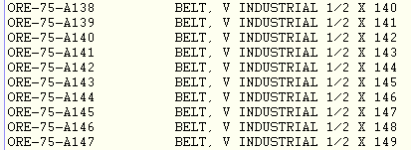

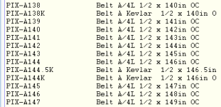

The PN is correct. But you can check by measuring the outside circumference. Now the belt is a 9/16" (14.29mm) wide belt and most aftermarket are being shown as 1/2" so you need a slightly shorter belt.
PIX belts smaller than the 150
Oregon belts
Most are available thru the local independent lawn mower dealers; although, they may have to order them. Personally I would stick to Kevlar one myself. I know I don't any of these in stock here.
