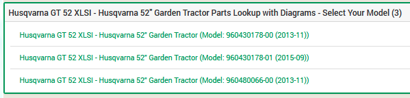

This is what I'm pulling up on different sites and it may or may not mention bottom steering support but none that I've found mention the specific upper support or bushing that I need.

116
12,618
To make the look-ups even more problematic is that inexperience doesn't take into account the different variations that a particular model might have as with this one. There is at least 3 variations of this model so you must use the long model number from the serial number tag.
Now as the two bushings one is listed the frame section and the other is in the steering section.
