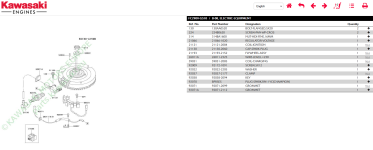

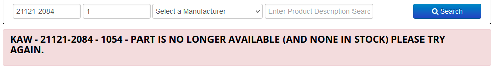

Houston, we got a problem here. The 21121-2084 coil is NLA from Kawasaki.
this what my distributor has posted.
