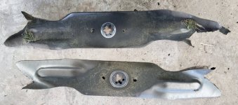

If you live in an area where the soil is sandy then to me that's a whole 'nother animal. Over the years I've seen pics of the effects sand has on blades and it's just crazy the way the metal gets eaten away. If that's your situation then I would just sharpen regularly and then recycle them long before they look anything like the ones in these pics....

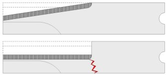

If you don't have sandy soil and are only cutting grass and not hitting a bunch of foreign objects then your blades should last years with regular sharpening, IMO. I have blades I've sharpened dozens of times and there's still plenty of life left in them. The pic below is taken from the Magna-Matic sharpener manual, and shows their opinion on the right and wrong way to sharpen a blade over the course of its life. I sharpened a blade last year that was getting close to looking like the bottom one. I showed the guy the picture and told him to get another set of blades. Although they don't explicitly say it, I believe Magna-Matic believes that you can sharpen the edge of a blade almost back to where the sail of the blade starts to curve upward. You can see that in the pic below as well. That seems to make sense to me.
View attachment 64171View attachment 64172
Had a customer years ago that lived on a river bluff area and over time the sandblasting cut the bottom inch of deck off his JD.
Yep. I've seen pics of decks with no rust, but had areas where the sand had worn them so thin you could see holes forming.

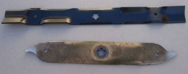

I don't know the correct way to sharpen a blade, but I'll describe mine... what's yours?
In fact, sharpening is not a very important item for many users, because even if the blade is not sharp, the cutter will shred the grass or any tree leaf... but the result is not satisfactory, in addition to causing greater consumption with more passes and even damage to the deck as a whole.
To those who don't sharpen, but change it after noticing an inefficiency, congratulations... it's the most correct way... but expensive.
Let's go...
With the blade off the deck, clamp it with a clamp on the workbench and clean (rust, glued and dry grass, animal manure, etc...), on all surfaces, using a grinder with flap disc, wire disc, etc.
After cleaning, I change the disk for an iron grinding disk (carburundum, diamond, aggressive flap, etc...) and grind at approximately 45° until I get a good edge.
After satisfactory sharpening, I move on to the balancing stage, an important procedure to keep the deck serene, without unnecessary vibrations that can cause loosening of screws, premature wear of pulley bearings, noise, etc.
To do this, just fix a rod with a rounded profile in a vise or workbench and hang the blade through its hole... the photos speak for themselves...
Cleaning the blade
View attachment 64029View attachment 64030
Cleaning up will make balancing easier at the end.
Sharpening...
Balancing
Blade one...
Very good...
Bade two...
Oops! Necessary adjustment...
Mark the side and remove material to make it lighter... preferably not on the sharp part.
Until equilibrium is achieved, several attempts can be made...
The end of the blade must be given special care, as it is the first to attack the grass... in any case, the edge is lost along the entire stretch due to stones, stumps, sand, sidewalks, hard fruit seeds and other objects. ..
Let's go...
Cleaning the blade
Sharpening...
Balancing
Blade one...
Very good...
Bade two...
