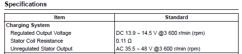

The stator AC @ 3600 should be a lot higher than 26 vac.
It’s not an FX850V. But if it were, this info is correct @StarTech.
