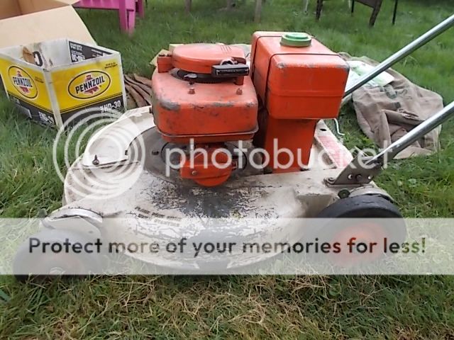

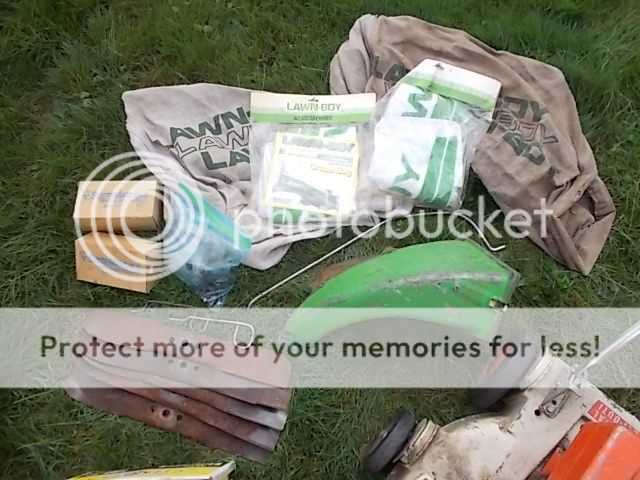

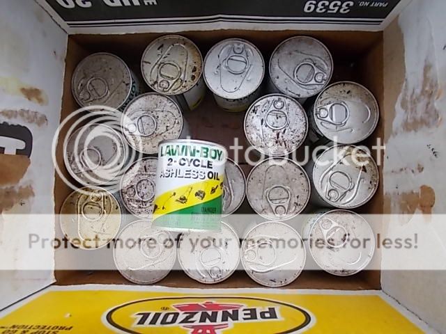

Traveled a couple towns over to buy this stuff today from the original owner....all in for $100:giggle:.....................Was told he put himself thru college by cutting lawns with a total of 5 of these mowers...the other 4 were worn out and scrapped decades ago. Said this one got engine work and then was put into long term storage. He gave me everything he had left...mower and manual, the 18 cans of oil, 5 spare blades, 2 used and 2 new bags, a couple new handle brackets, a ziplock bag of spare smalls, a mag chute...and a spare handle that didn't make it into the pix. It has good compression, a dry tank and no cracks in the deck...

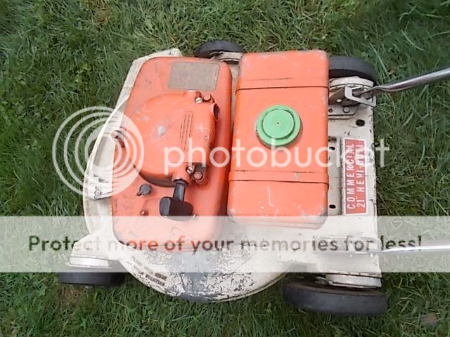

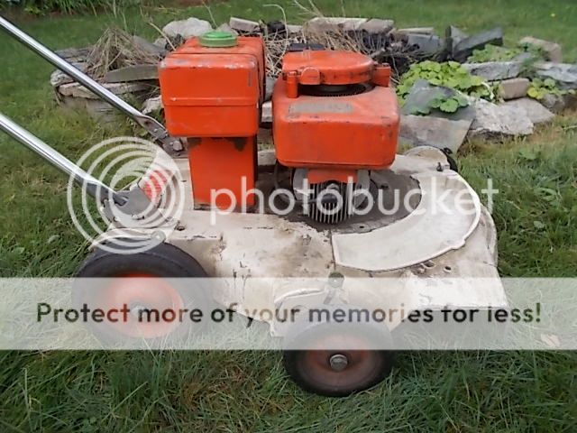

The 6252 is now running:cool: I gapped and installed a new plug, a length of fuel line, sharpened the blade, wiped out the carb bowl, and I had to cut out a air filter for it from some foam stock, then put some fresh 16-1 in the tank...and after a couple pulls it lit off, blew some smoke, and after a minute or so it smoothed out and the smoke went away...sweet! Lifted it in next to the driver 6259,and I used it on a couple lawns today for it's first cuts in maybe 30 years. The 6252 and a dirty little brother...
