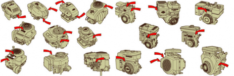

What condition is this mower in? did you buy it used as a fixer upper, or have you owned it since new and worked fine one week and not the next...or did you hit something with it and it died?
also post up the engine model numbers.

It looks like the one in the top right of that diagram you posted. Spark plug right on thr front, air filter on the left, exhaust on the right side.

The model number will be stamped into the sheet metal cover above the muffler or sparkplug
