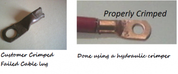

Which if these cable crimps would consider a well done crimp. Now course I had add the insulation sleeve yet which seals the connection.
Also here one that was over crimped that actually fused all the copper wire strands into one solid part.
Plus customer didnt even use correct size cable lug as he used a 4 ga lug on a 8 ga cable.
That is what you are looking for. A good crimp turns the copper strands into a copper block if you will. Best is a hydraulic crimp tool.
