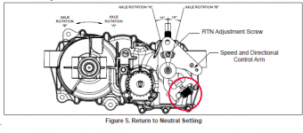

The neutral setup on the side of the EZT Hydros. Spring maybe missing
