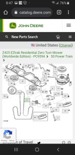

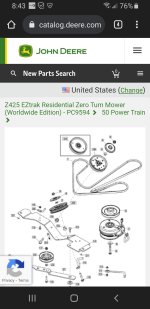

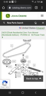

There are 3 different drivetrain versions of the z425. All 3 use different length belts. Be sure you have the correct one
107
12,086
What I see on JDparts is only two different belts. One for the wheel motor version and one for the all in one hydrostatic transaxles. What i have seen here is even JD belts are at their minimum installable lengths.
And yes 1/4" can make difference as you go lower the OD sizes. I got machines here that even a 1/8" is too much on a 32" sized belt.
