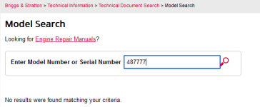

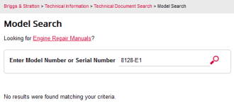

I wonder if someone could help me find the model of my Yardman ride on 42 inch mower ( so I can order the correct bely- apparently there are 5 options! ). The sticker has come off but I can find the engine details which are: model 487777, the 8128-E1, code 998922YG . Many thanks

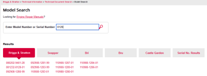

I still can't find anything on the B and S model lookup site , but Im sure its just "operator error" . All help most welcome
