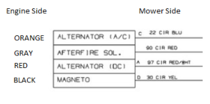

This should be the correct order.
Now the RED/WHT [mower side] looks to be sun faded toward the ORANGE/WHT.
You also need a Molex plug
or a
Both are the same plug just different manufactures and slight color difference.
Also both are Polarized Keyed so they only fit one way so watch the pin insertion order to match the current socket order. On each pin there are two wings that needs expanded a little more so they lock into the plug holes.
It look like faded Orange here but I personally went to shop looked at Bolens here and it is Yellow faded nearly White here. It definitely connects to the Blue on the mower side.
And as Rivets pointed out some colors do change from year to year.
