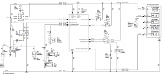

To OP. Do you have any power? If not you may have just blew the main 20A fuse. Otherwise yes you could have blew the
Vehicle Controller board but only testing will find the problem. Reverse connecting the battery can do a lot damage including blowing the voltage regulator and possible damaging both ignition coils.
Z810A Wiring Schematic

I see diodes all over the place on that wiring diagram. Like StarTech said, start with the 20A fuse but get ready for smoke when you replace it, if it is bad. Many electronics play poorly with reversed polarity.
