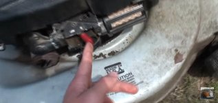

Here's one exactly like it. I screen grabbed the pic from a YouTube video. I'm trying to figure out what replacement part to search for.

To me you‘re over thinking it. Labels are cheap, doesn’t mean anything to me. That model Tecumseh engine had dozens of different uses and different control setups. Better to look on the type of equipment that engine was mounted on. That will indicate which control assembly was used.

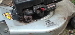

This is exactly the same engine. The red lever is the part I'm searching for. How do I find it?

I’ll bet that if you look on the engine ID tag you’ll find that the engines are different. You’ll also find that the linkage is different.
