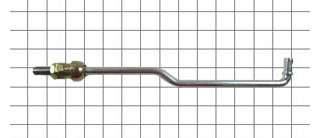

Does look something like this.
DianeDog
Apr 16, 2019
13
A little like that but more J or L-shaped and not as long a straight side. I wish I could post the picture.

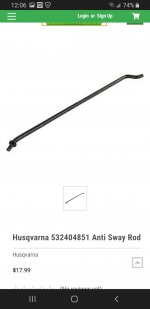

Most likely it is the stabilizer rod that attaches to the rear of the deck and the right side of the frame. It is a poor design and when the deck hits somethig hard on the left side it bends the rod and it falls out

It is the anti sway (stabilizer) rod. It is just badly bent.
Husqvarna PN 532404851

Yup. nailed it. It is the anti sway rod. The deck took a good hit on the left side.
