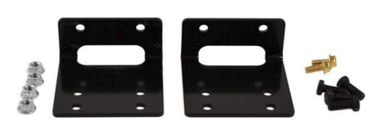

if you are referring this
Then a repair kit is available to repair the vertical draw bar.
5321437498
Thanks. I've built new brackets with 3 in. angle iron. I think I've moved the new brackets too far forward creating too much slack in the drive belt causing the belt to slip and loosing
torque to the K46. I'll keep you posted on results. I'm going to a friends house and get some real detailed measurements this week. Thanks for the help.
122
12,907
You can't move the transaxle forward if the anti-torque bracket is in place which real needs to be there so you don't the ears off again.
