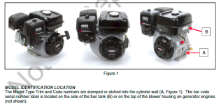

I am trying to find the B&S service manual for the Husqvarna branded pressure washer sold exclusively at Costco. PW 3200.
The part number on the engine says 13U2-80098013. I did find a repair manual for 13U200 engines here : https://www.manualslib.com/manual/1602171/Briggs-And-Stratton-130g00.html
Not sure it this applicable for this engine ?
Also I can't seem to find the replacement park plug (PN 798615) at reasonable cost spark plug here in canada.
Does anyone know where I can find cross reference to replacements in other brands.

Actually that HB32 is not the same model at all. the Costco unit is PW 3200 its clearly made by B&S its has B&S sticker model 020798 rev , Husqvaran AB and it used under license to Briggs & Stratton. LLC.
I wanted to adjust the valve lash. I use the service manual for the 13u200 as it look's like the same motor.
