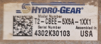

The transaxle is not a Tuff Torq but is a Hydro Gear T2. As parts what is the Hydro Gear model number on the transaxle?
As for the rotor it have very little play on the shaft spline, just to allow the rotor to self center [float] on the brake shaft. The rotor tend the one to wears it splines out.
None of the Tuff Torq K46 docs had the same brake assembly as mine, so I finally got desperate enough to look for a label on the transaxle. Turns out, it's a HydroGear T2, not a Tuff Torq K46. Duh. And there appear to be several informative references to this transaxle online... I'll post a link to the Hydro-Gear T2 service manual below, but I'm still looking trying to find out if my wobbly rotor is normal, but the service manual isn't so helpful there:

Funny, we posted the same thing nearly simultaneously. It helps to be searching for the right part, doesn't it? I'm not sure if you're saying the rotor wears out the spline, or the spline wears out the rotor but for $12 including shipping, I just went ahead and ordered a new rotor. Hopefully, I'll find I can just pull the old one off! Thanks!
