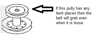

Basically your belt is trying move even when the clutch is depress and the engine is running.
107
12,074
All you need is a 1/2" x 88-1/4" belt. Many places are pushing the 1/2" x 88" but that is a little short and can cause problems.
The Rotary 8516 (1/2 x 88-3/8") which is 1/8" longer will work.
Actually the 144200 is supposed to be 88-1/4" long but suppliers will try to sub the 88" belt.
