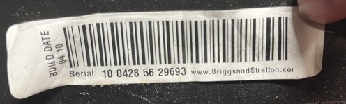

The mower is a 20334 with a Briggs 7hp, SN 10 0428 56 29693, build date 04/10. So far I've pulled the carb and cleaned it, replaced the plug and air cleaner, removed the muffler to be sure there was no clogged screen, pulled the top of the motor and cleaned the flywheel magnets and coil, made sure that the choke was working properly, then adjusted the gap to .010, sprayed seafoam in the carb while running, put Seafoam in the tank, and replaced the battery.
When cold, the mower will crank and crank and crank trying to start but won't... as if it's turning over too slow but it's not per the YouTube videos I've watched. If I pull the rope, it fires right up, unfortunately the owner is elderly and can't pull as hard as me. Once the motor has run, it usually starts on the electric starter. When I watch YouTube videos, these things light right off. The only thing that I haven't and most likely won't do, is get into the valve adjustment not being an OHV motor.

Please post the mowers serial number as I don’t remember Toro installing a 7hp Briggs engine on their steel deck mowers.
Lyndmc
Jul 21, 2019
22

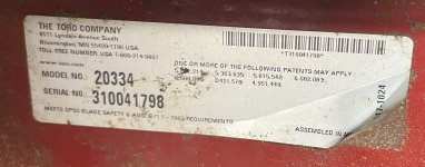

Those are Briggs numbers. I need the Toro numbers, look under rearbagger cover.

First, this is a 2010 model. When you cleaned the carb, did you replace the float needle and seat, plus adjust the float level? I’m guess that being that old the seat has swelled and it is resulting in a lean starting and running condition. I normally set the float level slightly rich which results in easier starting.
