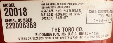

Apologies if I am misunderstanding you, is below what you are looking for
Rivets
Mar 11, 2012
61
15,570
No, you need to look for the ID tag on the engine, not deck.

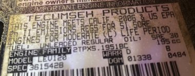

Rivets
Mar 11, 2012
61
15,570
That’s what I needed to confirm what engine you have. Engine model number is LEV120 with a Spec number of 361542B. If you are positive you have a good strong battery, I would probably replace these three parts. Gear #34949A, Driver #34946 and Drive Nut #34953. You may only need the driver, but I don’t like having to take it apart replacing one part at a time. Hope this works.
