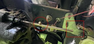

The shift rod 747-04146C is an MTD part and also used on a Cub Lawn Tractor from roughly 2006. I've attached a couple photos. I have the part on order and it looks like I can replace it without dropping the deck. While I'm waiting and cutting the lawn with a push mower I have a couple questions.
There is a small piece of round stock welded in the middle of the rod, does it have a purpose?
The end is threaded and looks like it can be adjusted. Is there any fine tuning to this, or if it goes forward, neutral, and reverse I don't need to mess with it?

That is used by some models to force the rod to the neutral position when you put your foot on the brake.
IT is cheaper to make them all the same than to make 2 different ones
And yes you will need to adjust the neutral position when fitted.
Instructions are in the owners handbook .

The purpose of that welded rod in the middle is to actuate the reverse safety switch to prevent mowing in reverse.

Well if it was a poisonous snake it would have already bitten you. It for grounding the reverse inhibit switch in the pictures

Ah! I see it now, that’s very helpful. It was near the switch but since it was broken it was just hanging. I did notice a slight wear along one side, I’ll keep an eye on it when I install the new one.
