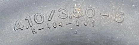

Thanks, ILENGINE. The rears are right, but I'm not sure about the fronts. They are currently Kenda Corsas, and size printed on the sidewall is 4.10/3.5-5. I don't understand that sizing. 4.10/3.5-5? What is that? And is it the same as 11x4-5?

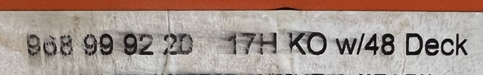

Here is a photo of the ID sticker. I guess that COULD be 968 99 92 20.
well now, that's the same # on the spec sheet I posted. Hmmm.....

Original tire spec's - - -
Front tire = 410/350-5, 4 PLY
Rear tire = 18x9.5-8

4.10/3.50x5 is approximately 11 inch in diameter. So maybe narrower than the spec'ed tire but same height.

Hmmm. Looks like tire size is not the reason I can't get my deck level. I don't think I can justify replacing the tires just to eliminate checking them before every use. I'll try the ATF trick, and see if that fixes the leaks. And look for other reasons for my deck issues.
Thanks, all, for the info.
