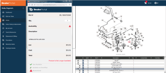

There are 2 different springs used on your drive system. Drive spring #1666759SM. Spring petal return #2156302SM. You might have to crawl under the unit to determine which one they replaced. Both springs are still available, so I don’t know their problem in getting you the correct one. This parts manual will help you locate the springs, pages 18-19. https://www.thepowerportal.com/ipls/ipl.htm?md=1692786~_IPLURL_LO.pdf
122
12,907
Rivets I have to disagree here as item 37 is NLA per PD which the Briggs main distributor.
The coil portion is about .58 OD x 6.9"

Well I might be wrong, as you like to point out every chance you get, but just did a search and found 4 sites who say they have one, not Altozon or Fleabay. I don’t have access to distributor sire so don’t know if it is available through them. The OP asked for help finding a replacement and I gave him what I found. Even attached parts manual which shows the same diagram as you posted, but as I’ve said to you before, “Yes Dear” your right.

It is # 37 on the page that the dealer said was unavailable, thanks for the replies and the dimensions
