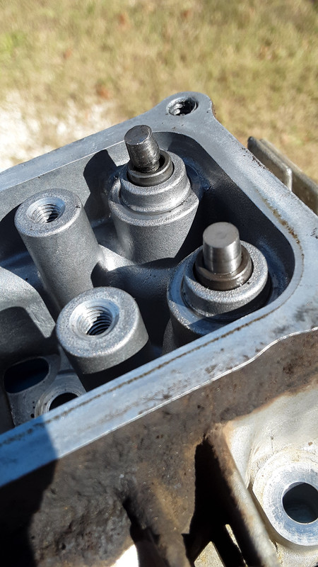

Ok, thanks for the various replies. The picture below was my situation. You can see that the intake valve stem is bent, so it naturally would not pass through the valve guide. Note that the exhaust valve is not bent, but will not pass through the valve guide either. This led me to believe that, somehow, the guide had to come out in order to remove the valve. Still, what I couldn't figure out was how the new valve was supposed to pass through the valve guide.
Well, I cut the head off the bent intake valve and removed it. I then took the new valve and tried it in the valve guide and it passed right through. I guess this means that the valve stem head must get fractionally wider over time, thus not allowing it to pass through the valve guide. This must be what Startech meant when he suggested using a file, to slim down the valve stem head.
So, the issue is resolved. I still don't know what this other valve guide Partstree sent with the valve is supposed to do. I put the link below, and you can see the piece I'm talking about in the picture at the link.

To the best of my knowledge the OHH engines did not offer a replacement valve guide, you needed to replace the entire head. The parts you received are a valve and keepers. Can’t really tell from picture, but the one valve guide looks severely worn to me. Have you measured it and compared it to the engine specs.
