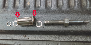

Well yes it is suppose to rotate if it is the one in the following picture of a disassembled flex shaft to trimmer head adapter that is at the end on the curved tube. These adapters are not meant to taken apart not are they available separate from the curve tube. The arrows are pointing to the two bronze bushings that are in the adapter.
The 16mm hex is machined on the shaft.
But the 16mm nut that you mention as machined to the shaft, that shouldn't spin correct? On the one I have that nut is actually spinning on the shaft.
